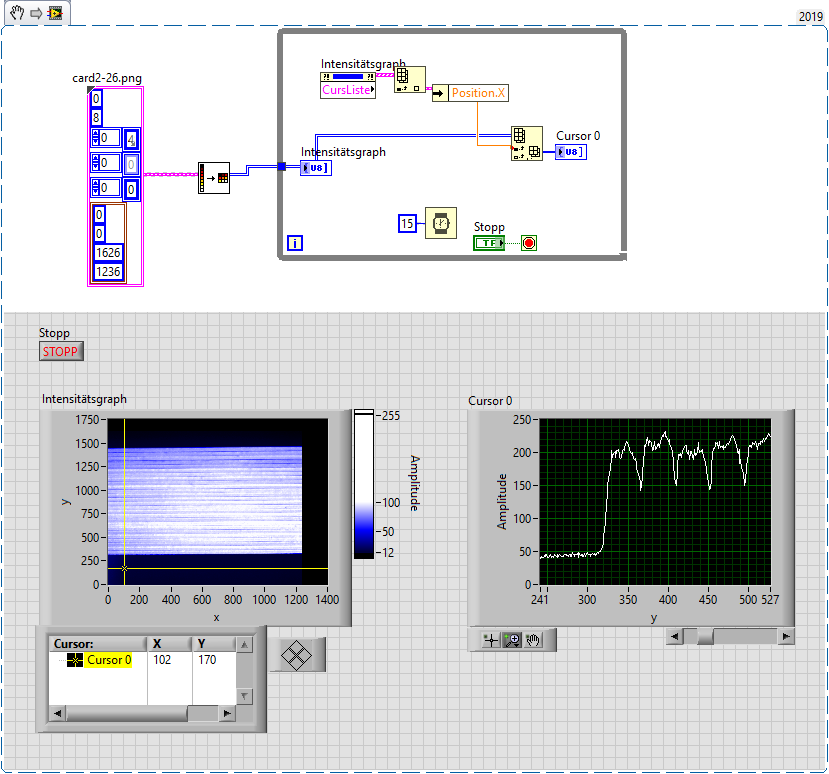

@Rahulbala wrote:
The solution is pretty easy now.
This task may appear to be easy, but could be tricky in detail.
in card2-26.png ... does the 26 tell us that there are 26 cards in this photograph?
The term edge detection may be misleading in this context.
I'd rather say you want to find local extrema in a profil line, somthing like this:
Message 12 of 15
(1,108 Views)
I'd also go straight to a profile line.
That reduces the problem to non-vision. You now have multiple 1D arrays that can be processed. Then process the results of each profile, and you'll even have some sort of quality check. If most profiles give n, you're good. If some give n-4 others n+4, you have a spread and that's not good.
If the cards are always the same thickness, you can of course get the nr of pixels between background-stack-background, and multiply it with a calibrated pixel\width ration... I think just like  Rahulbala proposed.

Taking a line profile may be a solution in most cases. If there is a dirt/black texture in the cards, and the pixel values might drop giving us a different count. If you are sure that there will never be such cases, then you can go with the line profile solution.
Edge detection might be misleading but I meant that you can use  "Find Straight Line Edge" VI.
