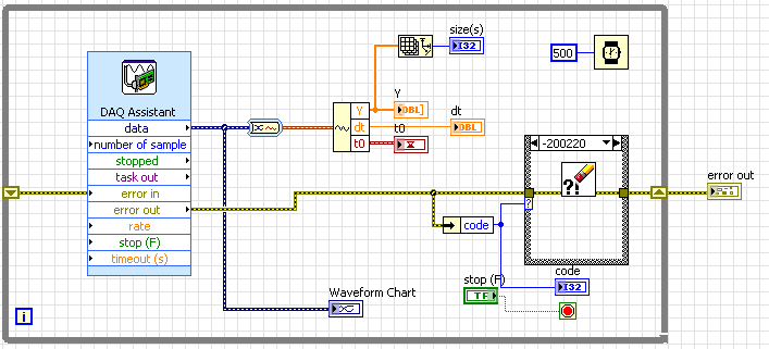

It is hard to tell without seeing the code. I looked at the VI Jaime F posted back on 11-1 and it has automatic error handling enabled in VI properties. The error out terminal from the DAQ Assistant is not wired. You might try turning the automatic error handling off and put probes on the error cluster wire in various places. If you can post the current version of your code with the data saved as default, perhaps someone can help.

I have one suggestion; something that might help is increasing sampling rate or the number of samples you are reading in the DAQ assistant.  To bypassing the error 20308 you need to replace the error tunnels on the while loop with a “shift register”, place a case structure that will clear the error if the error receive is -20038 it gets clear out. Also make sure you follow the previous post advise.
