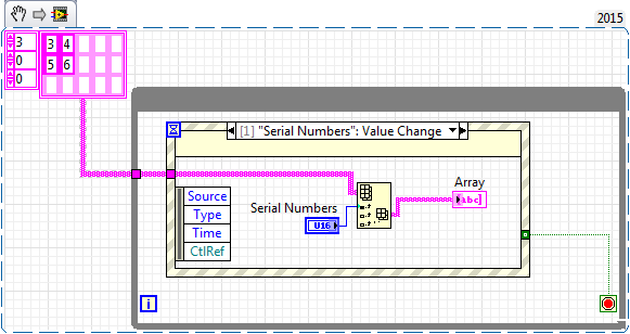

Do you know the number of pages?
And really, don't do this.  you are really asking for a lot of trouble.  Just display a 2D array and index the page to show by serial number

Number of pages rely on how many parts the operator selects at the start of testing can be anywhere from 1-42.
Thanks for the code you have shown that should work just how I want.
(3,175 Views)
Yup just populate the ring controll's "Strings[]" property from the user's part number selection.
