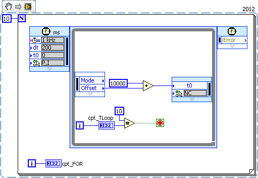

The setting D, M means that it keeps the phase (maintain original phase). I am not sure if this is what you wanted to set.
Norbert
Norbert
Expert: Geometry
Message 11 of 12
(572 Views)
D,M ---> P,I (or any other configuration)
no change, LV does not crash ... but the offset is not updated !
but all this does not explain why the LV crashes (with my first code)
IMHO, it's a bug.
