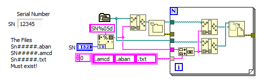

Here's a simple example that created a folder based on SN and moves three file matching the SN to the folder: The files are expected to be in the same folder as the VI, but you can easily expand that.
You don't need to test if the folder already exists, just ignore the error if it does (assuming that there won't be a existing file with that name). We also ignore errors if the move does not succeed. You need to expand the code to correctly deal and report all possible error scenarios.
Note that I am using a numeric control for the serial number. This ensure that only valid characters will end up in the folder/file names.
