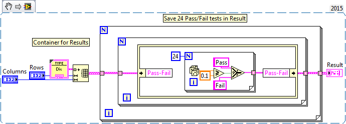

It looks like "Die" is what you call your "Array of 24 thingys" where a "thingy" is a string describing Pass/Fail of your device.  I created a Die Typedef as a Cluster containing an Array of Strings, then used it to create an array with a specified number of Rows and Columns (such as 4 by 4, selectable at run time) and then filled each of the 16 Die with a random set of Pass/Fail results (90% Pass, 10% Fail).
Is this what you are after?
