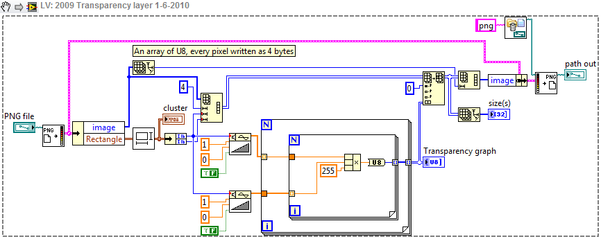

Hi Rob,
here's some quick mock up of what I'm talking about.
It produces a valid PNG and using paint.net I feel it is what I expected, but I am not sure.
Ton
My LabVIEW Ideas
(9,893 Views)
Thanks to Ton I have gone and learned something today.  A few years back (I have lost count) I wrote a set of PNG encoders/decoders because LV support for PNG files was marginal at best.  No alpha support, no buffer based manipulation, just file reading and writing (of certain types).  As such I have eschewed the LV VIs for the most part.  Now it seems that you can at least trick LabVIEW into writing the transparency information.
If you specify a bit depth of 32, the image array is arranged alpha-R-G-B for each pixel.  If you have a mask, you can convert it to a 1-bit pixmap and use alpha values of 255 or 0 for each pixel, and at least have crude transparency.  Here is my (now much simplified) VI to save the image data with transparency.  If you give it a 24-bit image with a non-empty mask array it will add the proper values to the alpha channel and promote the image to 32-bit for saving.
