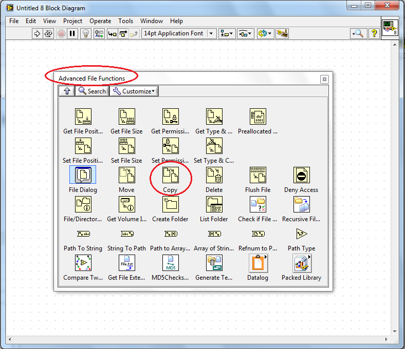

I have a VI designed to a user to write and update data that is displayed on a tree.  The data can be saved to an XML and can be opened for later use and updating.  My question, is it possible to tell Windows to copy the XML file and paste it in a different folder (back it up) via LabVIEW before the file is officially opened?  This way the user isn't responsible for having to do it every time they wish to alter the XML.

Yes, it can be done using 'Copy' node (available in 'Advance File Functions'):
