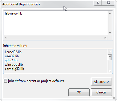

In MSVS2013 you can find it under:
Project -> Properties -> Linker -> Input -> Additonal Dependencies
There you have to options:
a.) add an aditional library (Seperator char is a semicolon ";")
b.) switch on the option: "Inherit from parent or project defaults"
Additional Dependencies MSVS C++

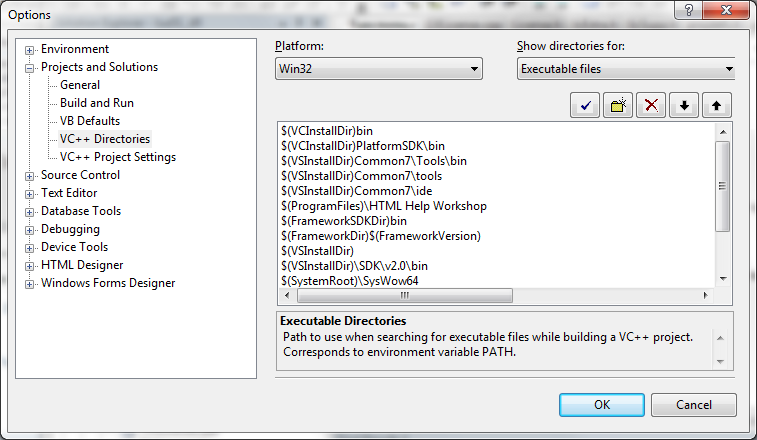

It's not an tnvironment variable at all in MSVC. Instead it is in the IDE settings. I still use MSVC2005 for most of my Windows C work so I can't tell you where exactly to look in your version. For me it is in the Tools->Options menu. In there is a section "Projects and Solutions" and there is a "VC Directories" selection. In this dialog you can set the various paths Visual C should use for binary executable files, include files and library search paths etc. Add as many paths to it that you commonly use in your MSVC development. I have added my LabVIEW cintools directory to both the Include and Library paths.
Rolf Kalbermatter  My Blog
