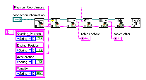

The string constant can be directly connected to the "table" connection of "DB Tools Drop Table.vi" as long as you remove the connection to the existing string control. If you are experiencing broken wires, use the Ctrl+B shortcut to clean up broken wires - then reconnect disconnected objects.

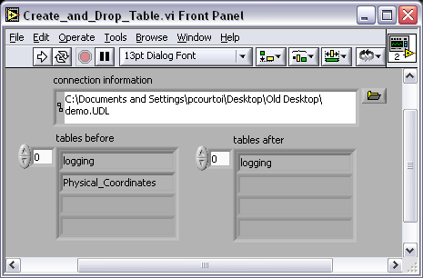

The "DB ToolsList Tables.vi" works fine. I used it before and after the table drop and the list DID show the "Physical_Coordinates" table to exist in the "tables before" indicator while it was not showing in the "tables after" indicator, because it had been dropped. Here's how my code looks like:

Although no errors show on the code, the Front panel did not show the "Physical_Coordinates" table to exist in the "tables before" indicator.

You say that you can't see the "Physical_Coordinates" table being created. Well, that's odd, because I see it fine:
If you remove the
"DB Tools Drop Table.vi" (of course keeping the "connection reference" and "error cluster" connected between the remaining VIs), do you then see the "Physical_Coordinates" table being created? When opening Access, do you see the table in there?
