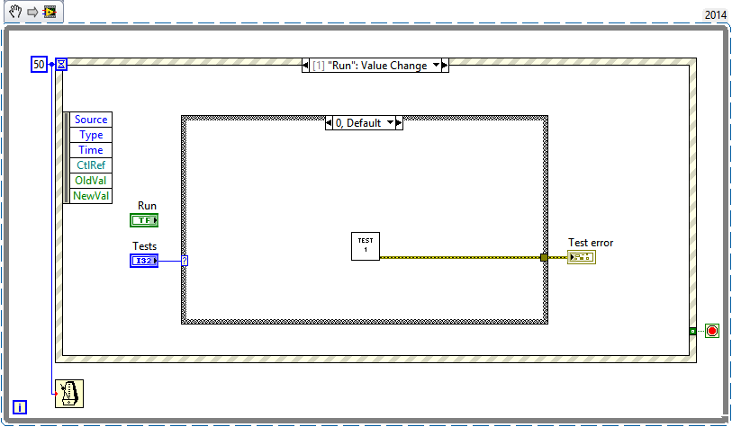

Architecturally this could be a lot better but the snippet below allows you add additional test relatively easily without changing the form of the program (simply add another Boolean and a case in the consumer loop to handle it).  Somebody'll be along shortly to suggest a different architecture (or maybe TestStand), I'm sure.
Biggest issues with what I'm supplying:
  1. the way it is coded, all of the test-related Booleans need to be labeled "test N".  The captions could be used to show more user-friendly test names.
  2. Once you hit "run tests" there is no mechanism for stopping the tests and the parent front panel will be unresponsive (although the individual subVI FPs will work if they are visible).
  3. the program will exit as soon as the selected tests complete.  To select different test you'll need to run the program again.

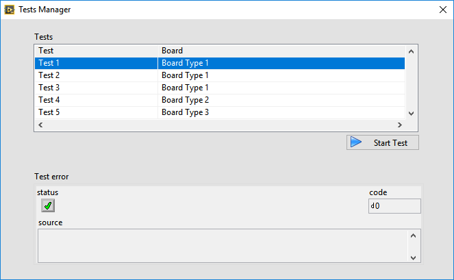

This an easier and more scalable way to implement it.
I hope it helps.

Is  "Tests Manager" only in the newer Labview versions or is it a program you have to download separately? (I only have Labview 2011) And with this program, are you able to run through all the tests at once or is it just one test at a time?
Message 4 of 11
(5,810 Views)
Hi I'm adding the VIs for your LV version consider that Test1 and Test2 needs to be substituted by your actual subVIs. You also have to modify the Tests Multycolumn Listbox to match your actual test information. In this case you only execute one Test at the time according to your request in the first comment. You can add as many tests as you have to the Test control and to the Case Structure.

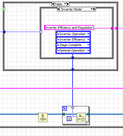

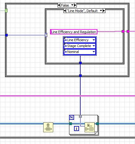

Assuming all you individual tests have their own sub-vi, I would use a "Queued State Machine" architecture. Each test would have its own "state" in the state machine
You would have a "select tests" state where you select the tests you want to run (or are selected automatically by selecting the bard type) and these test are loaded into the Queue and ran.
Here is an example: This program is for testing inverters...
In my "Nominal Operation" state I can select "line mode" or "Inverter mode"  tests to run
The selection loads teh queue with the test sequence I want to run.
This where I initialize the queue when the program starts, and shows the queued state machine control
