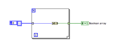

One issue is just what you want the output array to look like. Do you want a 2D array where each row reperesents the bits in one byte or do you want a 1D array with the booleans concatenated?
Here is how you could do the first.
The other is a bit more involved.
Lynn

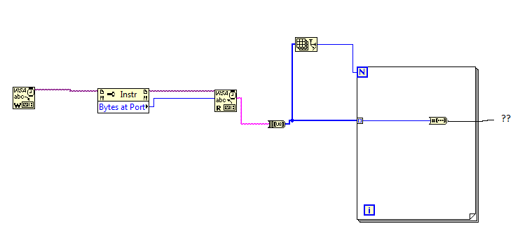

I believe the 2D array is best way...I could more easily go through each byte at a time to parse them, and act on them.
I see in the functions pallete, the number to array component you used in the loop...but where is the boolean array object you're feeding into there? I can't find that.....
From your example I'd go something like?
Thank you,
C
Message 15 of 29
(2,388 Views)
It's an indicator.
Wire from the Number to Boolean Array to the edge of the For Loop.  You should wind up with an auto-indexing tunnel.  Then right click on that and choose Create Indicator.
PS:  You don't need to get the Array Size and wire that to the N node of the loop.  That is taken care of automatically by the auto-indexing input tunnel.

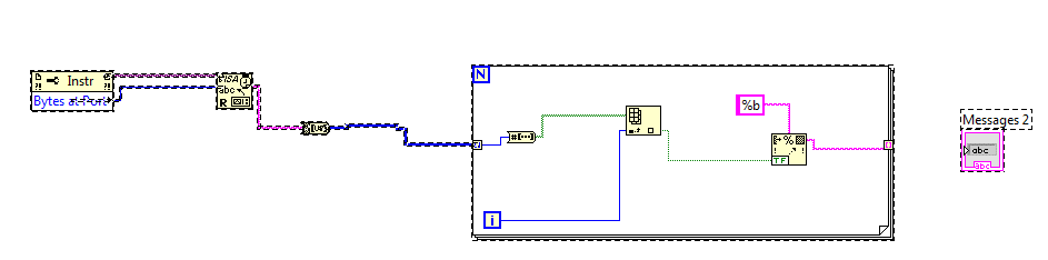

I'm needing to initially display this into a text box....iterating through the array....converting it to string, and printing each row of bits for each byte, a carriage return , then the next.
I need this  to start out with, to show what I'm receiving on the screen...I'm going to have messages going back and forth eventually...and am trying to use the text box "Messages" (indicator seen on the other vi examples I'd show where I had it totally wrong)...but I was wanting to show each byte array as a row on the text box area indicator and have them scroll by as they were received (will also later put in there what is sent, so I can compare sent to received).
Is this closer to what I'm needing to do?
I can't connect to the Messages area yet...I'm just not getting how to iterate through this byte array, and convert it to rows to print to the screen...
Dislplaying on the Messages area like
11100001
11111111
11111110
etc...
Thank you for the links...I'm trying to look through all of those now too!!!
I've been trying to learn all this from my read through of LabView for Everyone. I'll need to go back to find the chapters on for loops and the index tunnels, etc...looking into all this now.
If I can just get this example in my head and vi down...I think I can figure it out....I've just never tried working with bits and bytes before...very confusing, and not nearly as straightforward as working with text/strings, with construction, parsing, regular expressions, etc....

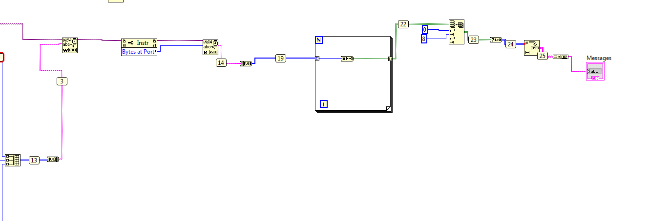

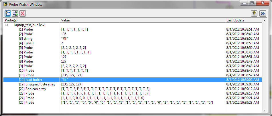

Thank you. Good advice.  I think I'm a bit closer now, and have done what you said, and I've set a bunch of probes, and breakpoints, to go through and see how things really were working.
I'm much closer now, but have a question at the end, where I'm receiving the byte array back..I've successfully converted it back to a boolean array.
At this point, I'm trying to use an Array Subset, to grab off the first 8 bits, but it seems to be sending them all for some reason, and I'm a bit stuck.
I'm attaching the vi to this point.
Here is the section where I"m trying the subarray that isn't working like I thought it would:
This is the readings on the probes:
Message 19 of 29
(2,370 Views)
cayenne,
I am not sure what you are expecting that you are not getting. The bytes are there. The bits are ordered with the least significant bit on the left. Since 127 has seven 1s the eighth bit is a zero.  It is there because averything is done in 8-bit bytes.
