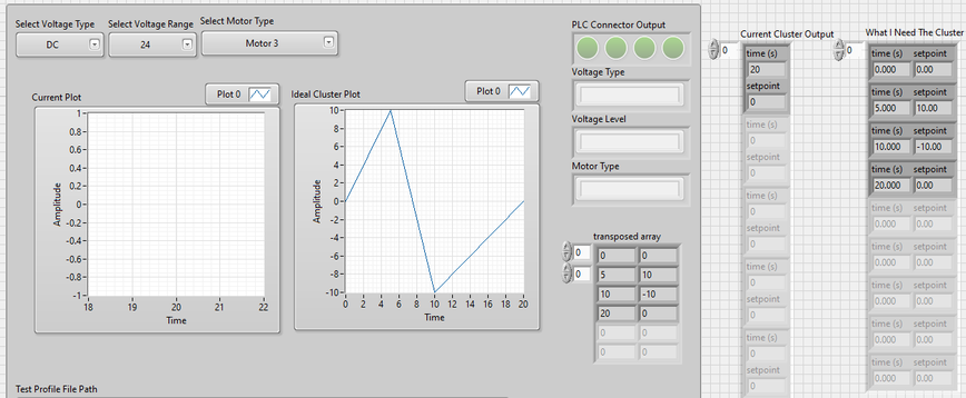

I for some reason cannot get my cluster output to match the same cluster that the PID is expecting. I've included pictures of the data types for each, display windows for each and the block diagram of how i'm creating this cluster. For the example below, the ideal cluster values are the same values i have in the CSV file.

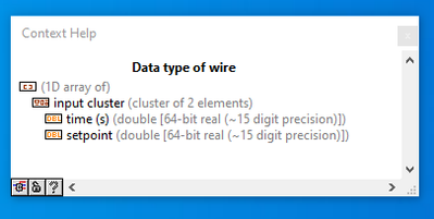

Data type of the cluster I’m trying to mimic

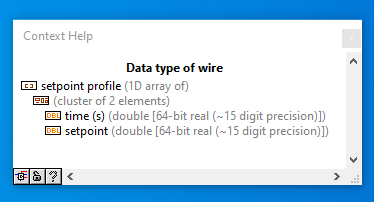

Cluster that I’ve made by importing values from a csv file

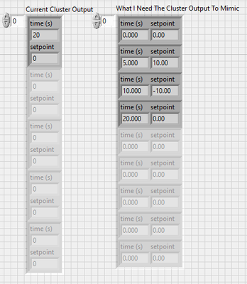

Outputs: The cluster I created is vertical, “time” on top and “set point” below it. The cluster I want to mimic has time on the left and setpoint on the right.

Display

Hi Amagis,
Right-click the cluster border-> autosizing -> arrange horizontally…
Recommendation: type-define your clusters!
