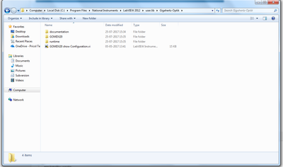

So the APIs of the sensor and its corresponding .dll are stored in user.lib as shown below,

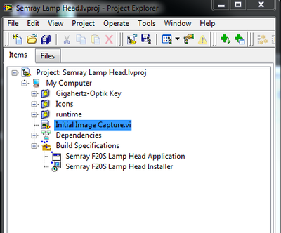

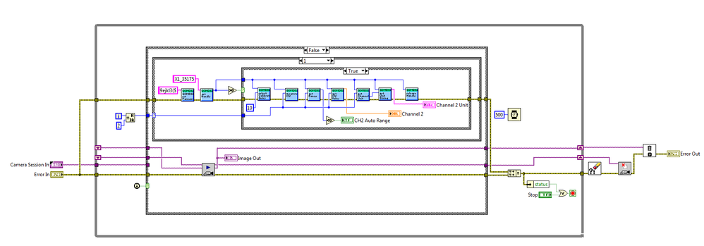

My Initial Image Capture.vi is calling the library from user.lib and image capture functions IMAQdx and IMAQ functions as shown,
So when I build the executable I have included the .dll files (runtime) folder in always included.
When I select the installer the executable file will be looking for the .dll in the user.lib folder right?
