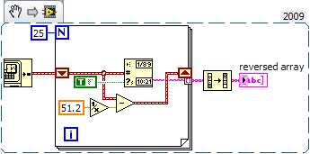

As Lynn points out, you may not need a timestamp for every point if the time between points is consistent.  If you do want an individual timestamp for each point, instead of using Initialize Array you could use a for loop to generate the correct number of timestamps, incrementing (or decrementing) the value each time.  For example, if you assume the current time corresponds to the last measurement, you could use something like the code below to generate an array of timestamps.
An improvement over this would be to use a shift register in the main loop of your program, initialize it once (from the outside) when the program starts, and then continuously increment the timestamp.  This way the difference in time will be consistent from one group of points to the next, but it is possible that it will get out of sync with real time if your program is slow for some reason.
