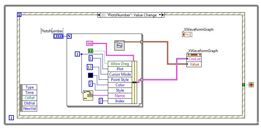

Hello
I'm trying to programatically create cursors in the Waveform Graph. I want to have as many cursors as plots in the graph. See the attached VI. And now the weird thing: when I decrement number of plots, everything is OK - plots are shown, cursors are created. But when I increment them - I get "Error 1077 - Invalid property value." from the Cursor List Property Node.
So the typical question: is it me or LabVIEW doing it wrong? 😉

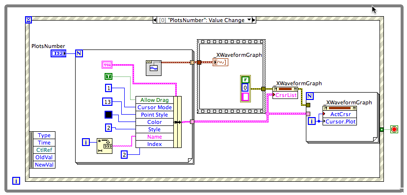

Hmmm.. Surprising, I have to say I don't know why you get this error, but to solve the problem here's what you can do, remove the "Cursor Plot" from entry from your "bundle by name" that's in the loop (the default value of 0 >> first plot" will be kept and after setting the cursor list, re-set the correct plot / cursor association. See this :
Anyway, if someone can explain why this error comes up, I am interested in knowing why.

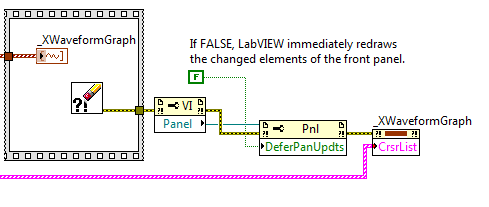

Still impressed by this thread  (Front Panel Control/Indicator Update Speed) I added a DeferPanelUpdate before writing the CursorList:
As a result, LabVIEW redraws the FP and then writes the CursorList without any error!
I must confess that I do not like this workaround.

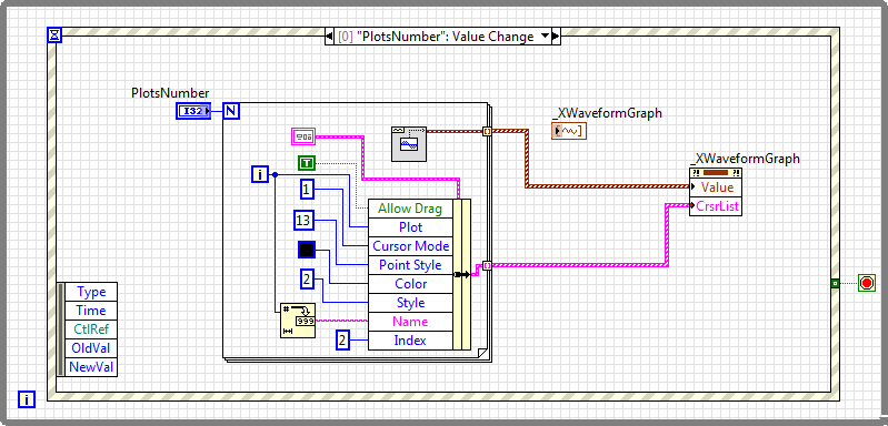

As writing by terminal is asynchronous, it does not guaranty that it will be finished before writing to CrsrList property. Even if writing to CrsrList property occurs letter on the block diagram, and even when writing to property node is synchronous. Therefore the application mentioned above requires using fully synchronous code as below:

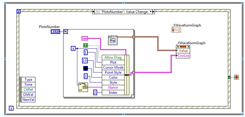

It is to work without any additional delays (wait functions). Please also note, that property node updates properties in order in which they appear on block diagram (from top to bottom). This is why the code shown below would NOT be the proper one:
