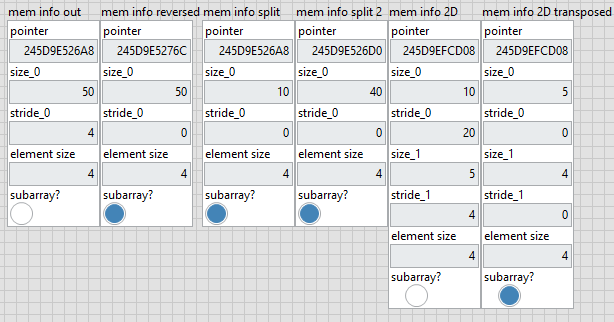

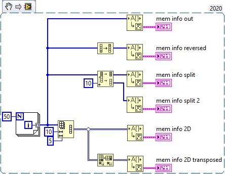

We can read this information with the vi ArrayMemInfo.
It gives the pointer to the first element, the size and stride of each dimension and the element size. The stride is the number of bytes to skip to get the next element in a given dimension.
Modifying this information would allow me to do efficient windowing and much more.
From the answer I got on lava, it is theoretically possible but there is no documention on it.

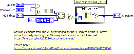

Alternatively, any particular "slice" can be extracted on demand from the original array by doing some simple integer math on indices. No need to copy the original array. Basically for any given set of 4D indices, you can calculate a 2D index pointing into the original data from first principles. That won't be any slower than what a subarray transform would do. All you need to create is a inlined subVI that takes four I32 inputs and generates two I32 outputs. (That's exactly the same as what LabVIEW does with subarrays, e.g. swap 2D indices instead of transposing the data, calculate the 1D index from the end (based on I and N) instead of reversing the array, etc.)

@altenbach wrote:
Basically for any given set of 4D indices, you can calculate a 2D index pointing into the original data from first principles..
Here's a quick draft how that could look like:

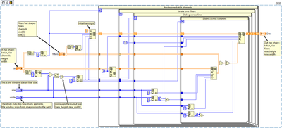

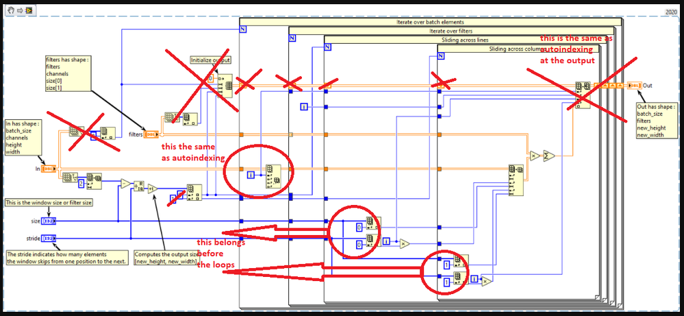

Here is a naive implementation of a convolution.
This is really slow. One way to make it faster is to move the multiplication and summation out of the loop and do it later.

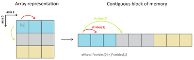

So this is how it is done in Numpy, PyTorch and other librairies. Arrays (or Tensors) also have a shape and strides like in LabVIEW and there is a function to change them to create a "view" of the same array without any data being copied.
By changing the shape and strides, you only change how the data is viewed as the array is in one contiguous block of memory.
The adress of the element at index i,j is pointer + i*strides[0] + j*strides[1].

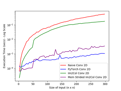

To illustrate the gain in time, here is a plot from the linked article.

@altenbach wrote:
Of course you can equally well create a subVI that returns any given 3x3 window (or any other size), given two indices and a direction. That's exactly what subarrays do internally do (doing simple integer math instead of creating a new data structure).
Yes, it is slow because it shuffles a lot of data around, not because of the operations.
While the code can be cleaned up significantly (see e.g. the picture below, but that won't really make a difference in speed but much easier to read, maintain, and debug).
Shouldn't the filter array size depend on the blue inputs?

I really need to create the redundant data because BLAS is faster than making the operation in the inner loop and because the convolution is done on all the input data. As far as I know, this is not something I can escape and is a key part in making convolutions faster....
Yes, the blue input size is the same as the last 2 dimension size of filters. Each window has the shape as the filters.
