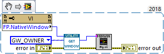

Customize All Windows dialog?
Find the Owner Window:
        Title: LabVIEW
        Window Class: LVFrame
When Owner window minimized, all LabVIEW windows will get minimized.

Thanks. I created a button, added and case and I pasted it in.  It causes very strange behavior. All of the LV windows minimize but they loose their graphics & preview thumbnails on the taskbar. Even after restoring various LV VI windows, they are not redraw correctly. Only after I individually minimize and restore them do they "paint" correctly.  I wonder if there is a 64 bit version of user32.dll that might not cause these issues.
Message 12 of 13
(687 Views)
It turns out VIs become hidden rather than minimized.  My bad.
No.  LabVIEW won't let you config a wrong bitness dll.
