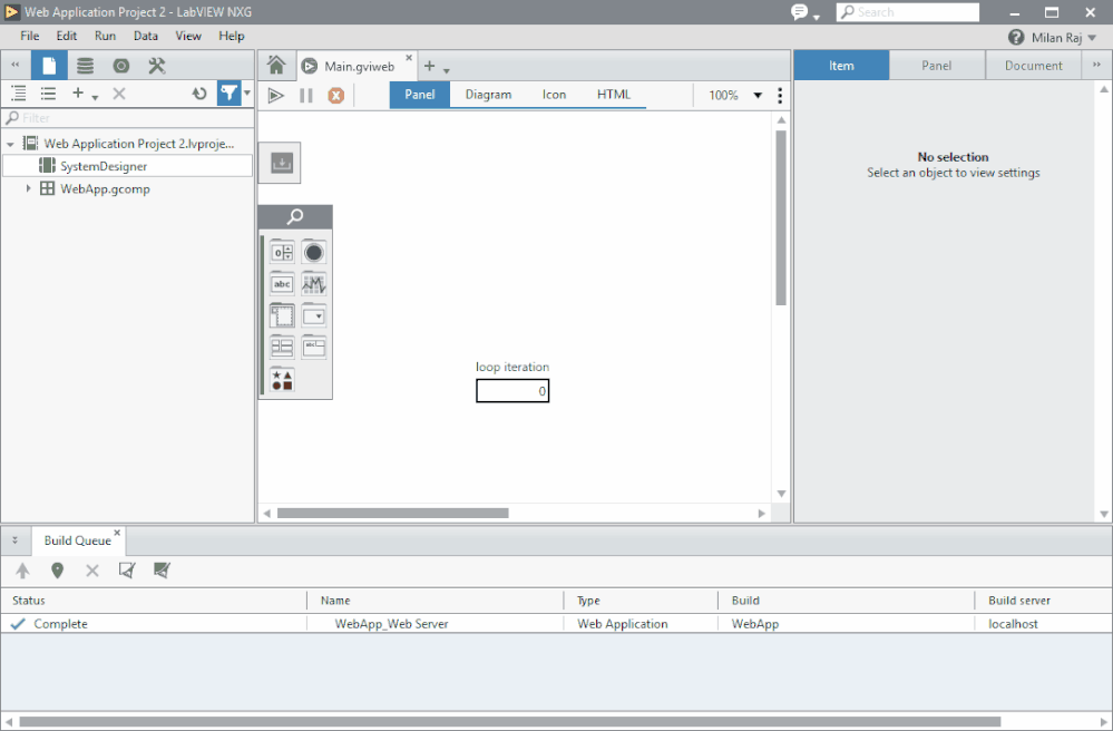

Does that refer to opening System Designer, right-clicking on the Web Application component, and choosing run to launch a Web VI? For example as shown in the following gif:
If that is the approach you are using then unfortunately the URL is not predictable. The Run action is intended for debugging and testing purposes and uses the first port made available by the operating system. Because of this, choosing Run from System Designer will use a changing port.
Instead if you want a consistent URL you should deploy the finished WebVI to a web server. The topic Hosting a Web Application on a Server describes how to deploy your WebVI to different web servers.
