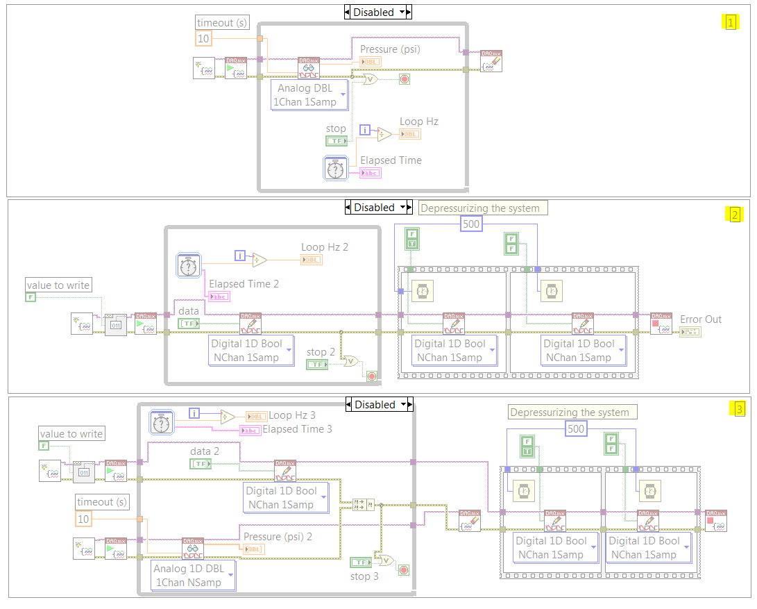

I'll need to edit my post above. I made a mistake when I said the loop was running 1000 iteration per second --- that shouldn't be possible and I'll explain why below. Most likely, I put the AI read on continuous sampling mode and the DO was on no-op as you mentioned.
I made the VI below really quick to test the DAQmx speed in 4 different scenarios and see how fast they can run. All my tasks here were set to On Demand Sampling.
Scenario A: DAQmx AI read alone (On Demand) - Diagram-1 enabled only
Speed: 360 iterations per second (2.7 ms per iteration)
Scenario B: DAQmx DO alone - Diagram-2 enabled only
Scenario C: Diagram-1 + Diagram-2 enabled only
Speed: 215 iterations per second (4.65 ms per iteration) - (both loops had same speed)
Scenario 😧 Both DAQmx AI read and DO in same loop - Diagram-3 enabled only
Speed: ~200 iterations per second (5 ms per iteration)
Scenario D explains why I am having 180 to 200 iterations per second for the code attached in the first thread.
I never used Labview before to perform data acquisition and control in the millisecond time frame. Do you believe these number are the best that I can get with the instruments (+ software) that I am using? Or is there any way to go faster (especially in scenario C or D)?
Thank you again for your time and help, they're really appreciated.

Accepted by topic author Osa_111
Generally speaking, you're probably pretty close to maxed out with your cDAQ system.  Here are 2 ideas that might help you incrementally, but probably not dramatically:
1. For the DO task, you really only need to perform the Write when it's time to toggle the control valves.  You don't need to repeatedly write the same data over and over during the other loop iterations.
2. For the AI task, you could consider a buffered acquisition.  Then the driver will stream data across USB in the background and your call to DAQmx Read will be retrieving from your PC, which should be a faster operation.  If you do this you should probably read all samples available.  This is the default when you don't wire a # to read.
   Note however that even if this speeds up your loop, it doesn't tell you exactly how old that "most recent sample" is at the moment you retrieve it from the PC buffer.  There's a chance that your AI data both comes in faster *and* is more stale.
-Kevin P
