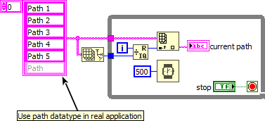

Create an array of paths and cycle through them using the remainder of [i]QR[array size]
(1,177 Views)
Works perfectly, thanks!
