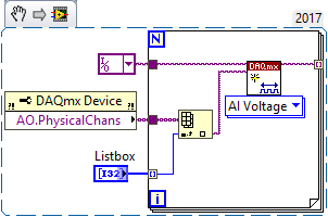

First, don't go with the bool or four bools  Use a listbox with the output as array and selection mode 0 or more (auto index the indices to build the channels from the array of selections)
Ala Kazam!
Nicely SCALEABLE!
Second, DON'T DO THAT!

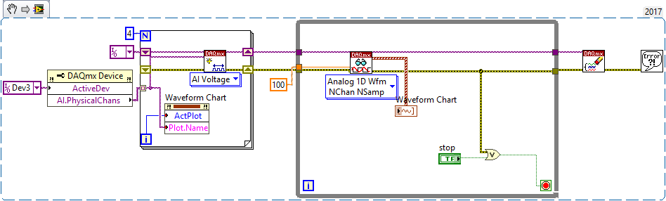

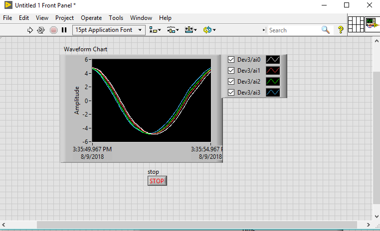

So, You got 4 AI Channels.  Read them ALL ALL THE TIME!  Use The Plot Visible Property to display only what is interesting and (Just saying here) Read the plot visible property to stor only the channel data of interest *(to TDMS of course)
NOTE: The For loop should auto-index on all AI, My device has more than 4 AI.Capture2.pngCapture2.png

Hi Jeff, I wanted to try your latest code but I don't think it is saved as a snippet somehow or I am just not importing it correctly? I tried dragging your image directly onto my block diagram but just a blue hyperlink appeared instead. I saved your image as a .png and dragged the file from windows explorer onto my block diagram page and your image appeared but it wasn't code; it is just an uneditable image... How would you advise?
Message 7 of 17
(5,658 Views)
What version of LabVIEW are you using?  Do notice that the snippet was saved with LabVIEW 2017.
Message 8 of 17
(5,651 Views)
Ah I'm sorry, I have 2018... Is there any way to convert or make it compatible or should I just replicate from scratch?
Message 9 of 17
(5,648 Views)
Hi laps,
1. click the snippet image to start the forum's image viewer.
2. Download the image from that image viewer using it's download button.
3. Create a new VI, open its block diagram window.
4. Drag the saved image from your download folder into the block diagram.
Ready!
(That's how snippets work!)
