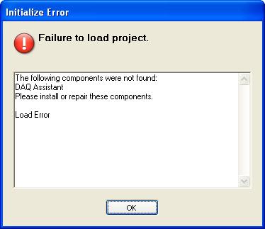

In addition to this issue, I'm getting the "initialize error" message below when DAQ Assistant is double clicked from the VI that is previously working. I hope this will narrow down this issue.
Thanks again..
Please note that I've repaired and updated DAQmx already but still the same result.
