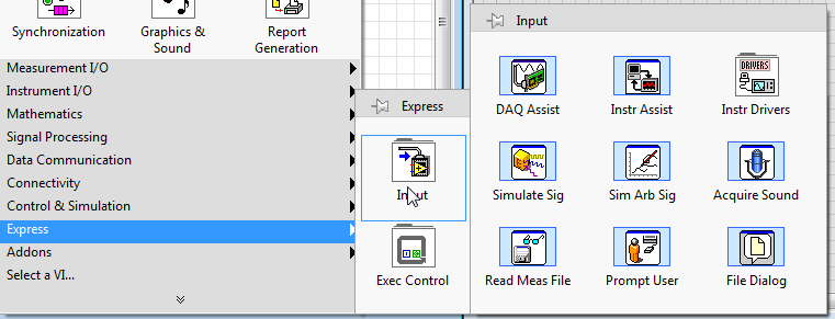

The DAQ assistant missing from function of LabVIEW 2017. (I first install NI-DAQmx driver before install LabVIEW). What should i do to fix this problem ?
Thanks.
(I have LabVIEW 2017 and DAQmx version 17.0 as shown in attached files)

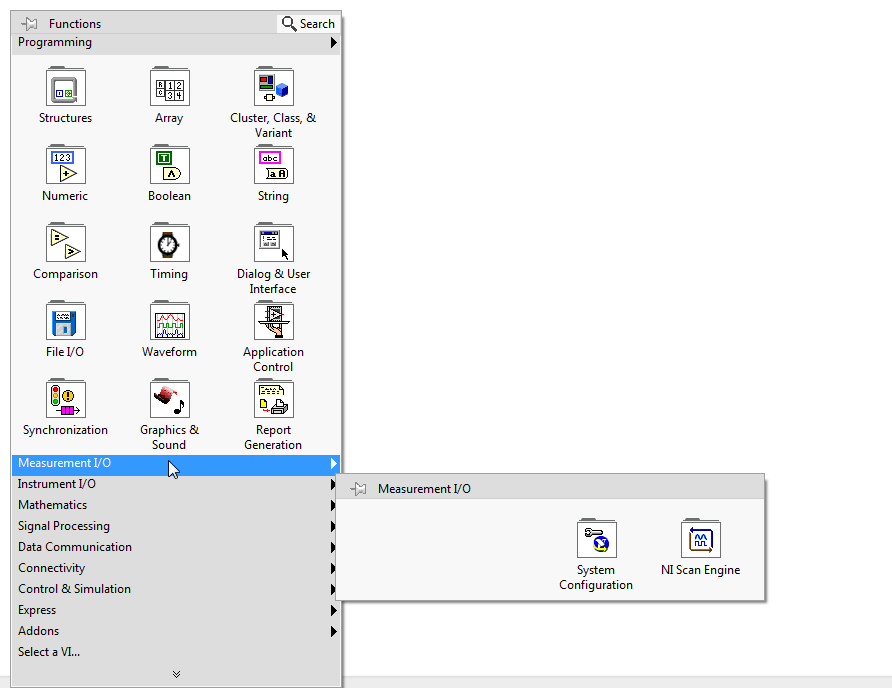

I guess you also don't have DAQmx functions though, so perhaps you can try reinstalling the DAQmx package?

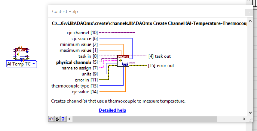

On your first point, you never HAVE to use DAQ Assistance. Internally, they use the DAQmx functions usually available under 'Measurement I/O > NI DAQmx' palette. These are more low-level functions that allow you to make measurements with NI DAQ devices (including the 6003).
An example VI is this Create Channel VI, set to an Analog Input > Thermocouple. This VI has many of the same inputs as are shown in the DAQ Assistant in the youtube video you linked.

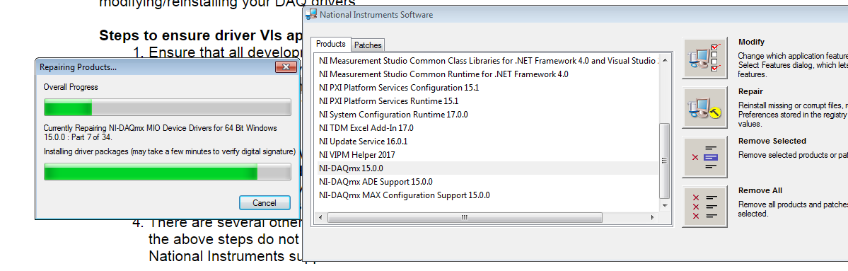

The bad thing is downloaded files was deleted. Can i uninstall DAQmx driver and reinstall DAQmx Driver by using DVD driver that came with my products ? .
(i try to repair DAQmx Driver, but didn't work)

In the screenshot, it shows you repairing DAQmx 15.0 (not 17).
I'm not sure if the DAQmx package is on a DVD - sorry. You don't need to reinstall LabVIEW, but the setup panel might show you installing LabVIEW. If you don't uninstall it first, it will 'install' very quickly, effectively just skipping. That might work out for you quickly if it is on the DVD.

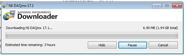

Thank you ben 64 i  try to reinstall and ... this is the time that it take form me hahaha.
and after that i've got DAQmx function in my LabVIEW.
