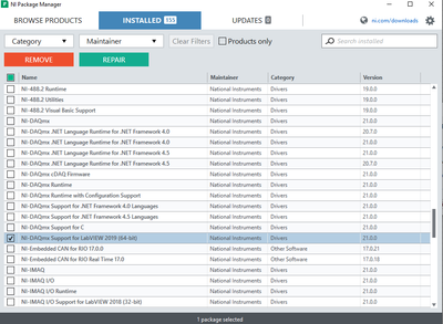

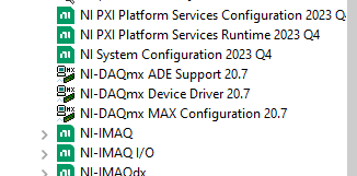

I am running LabVIEW 2018 SP1 (32 bit). I have uninstalled NI-DAQmx and re-installed it, currently on version 20.7, which is compatible with my version of LabView. These are visible in NI MAX and the Package Manager, as shown. The driver has been installed after LabVIEW.

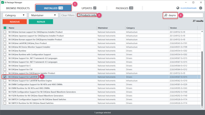

1. Open NI Package Manager
2. Under INSTALLED tab. Uncheck Product Only.
3. Search for daqmx.
4. Make sure NI-DAQmx Support for LabVIEW is installed. If it is not, run the NI-DAQmx installer again,

I have NI-DAQmx support for Labview 2019 (64 bit) installed, and I am running 2018 32 bit. This doens't change when unistalling and running the installer agian. Is there a way to force it to download the 32 bit version?
