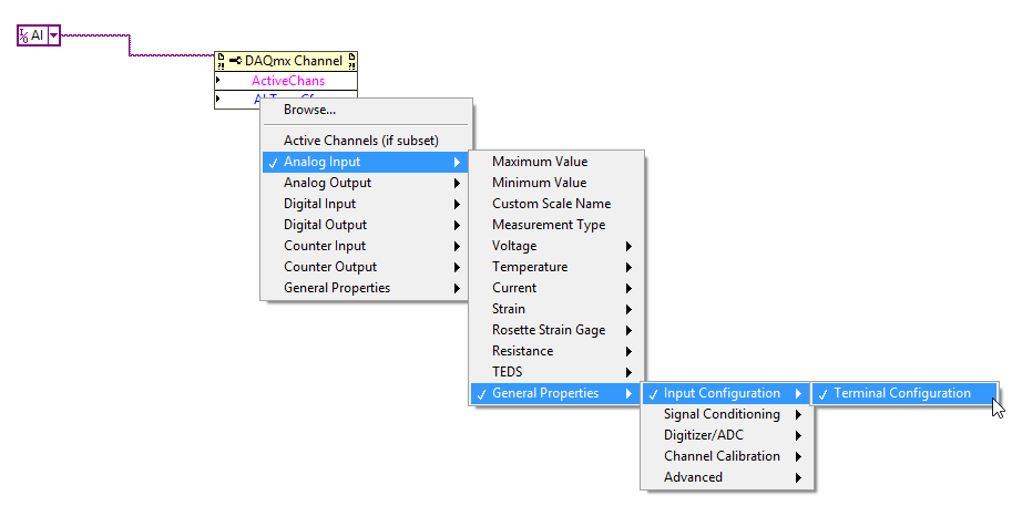

I use the following DAQmx Channel node set the coupling, bias, etc, for my channels. I set it dynamically before the task starts.

EDIT: misread your question. Are you sure your device supports it? There is also a way to show all options when browsing.

Right click the top of the property node and select filter, Show All Attributes.

Kudos for that!  I never knew about that filter!   (Similarly, there's one for DAQmx terminal nodes that often requires right-clicking in order to "show advanced terminals".)

Thanks for the reply!  It was that filter... didn't even know it existed 🙂
And yes, the hardware supports it.  I just didn't have the hardware configured on my development PC - just the deploy, so that filter masked the option to change coupling.
