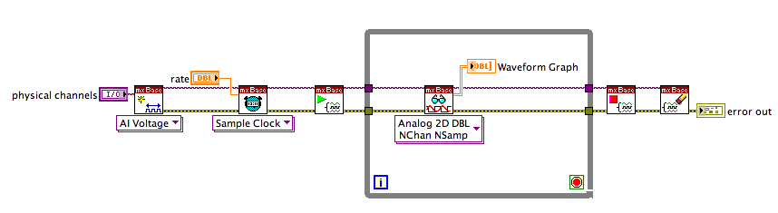

As Dennis said, you can certainly use many DAQ devices on the Mac. However, you will not have anything like the DAQ Assistant (which often causes more problems than it solves anyway). You will need to use the DAQmx Base VIs. A simple VI to read data from an Analog Input channel and display it on a graph would look something like this. It is missing a few things but this is the general idea.
Which DAQ device do you have? Is it one which is supported on the Mac OS?
Lynn
