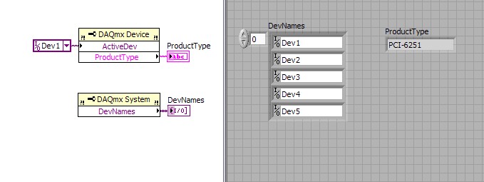

Hi, Max.
In reading through your original post, it seems as if you want to display the Device Names using the DevNames Property.  This property is found in the DAQmx System Property Node (Measurement I/O»DAQmx»DAQmx Advanced»DAQmx Constants and Property Nodes»DAQmx System Property Node).  The following screenshot is an example of how exactly to utilize DAQmx property nodes to display the Device Names as well as Product Type of the specific Device Name:
Is this the information that you needed?  Let me know if you have any more questions, or if I had perhaps misinterpretted the question.
