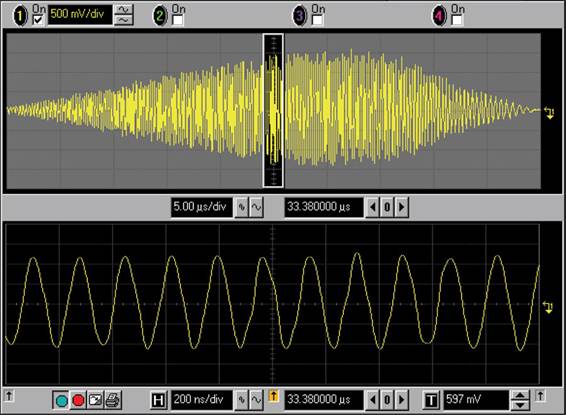

I try performing data acquisition by using external sample clock as reference.
I use the example from Labview 2012 "niScope EX External Clocking.vi", sending in an irregular sine wave as sample clock into CLKIN, then getting data from channel 0.
The moment I run this VI, the error prompt :
"Hardware Clocking Error occurred."
If you are using an external sample clock or an external reference clock, make sure it is connected and within the jitter and voltage specifications. Also, verify that the rate of the external clock matches the speicified clock rate."
Then, I change External Clock Rate to 3 MHz, error prompt that the clock rate is not valid.
The generated signal I had used is as shown below, a sine wave period of 220ns to 300ns (Around 4 to 7 MHz), less than 2V .
