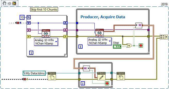

So here's the idea.  Your Producer Loop is running, generating 100 samples of 100 points at a time.  You want to delay writing for 1000 samples, or 10 loops.  The easiest way to do this is to put two DAQmx Loops in sequence, the first (without a Stop button) that takes the 10 samples and does nothing with them, and the second (with the Stop Button) that takes the rest of the samples and sends them to the Consumer.  (You could do this with a single loop having a Case Statement inside, but the stopping conditions get messy).
The traditional Producer/Consumer manages sending data between the parallel loops using a Queue.  I prefer to use Asynchronous Channel Wires, as I find them a better "metaphor" for Asynchronous Transfer of Data between parallel processes, so that's what I've done.  Here's a Code Snippet:Offset First Saved DataOffset First Saved Data
The two loops on top are the "Take 10 sets of data, not saving them" and "Take data and send to parallel Loop that handles saving them to TDMS File", i.e. the Producer.  The Consumer, below, opens a TDMS file and then waits patiently for Data to be sent from the Producer -- when it gets a Chunk, it writes it to the file.
The funny-looking "Brown Pipe" (Brown = Waveform Wire color, Pipe = Asynchronous Channel Wire, which "sits on top of" Structure boundaries, like the While Loop, signifying that the Data simply flows "over the top" of the Structure as fast as it gets put in (or taken out).  The Stream Channel Writer and Reader (those rectangles at the ends of the Channel Wire) have additional inputs that simplifies stopping them -- I've wired the Producer "Stop" wire into the "Last Element?" input of the Stream Writer, and wired the "Last Element?" output from the Stream Reader to the Consumer's Stop Indicator, so when the Producer stops, it "tells" the Consumer to Stop.
And there you have it!  You can do the same thing with Queues.  Sending a "Stop" signal is a little trickier, but if you look up "Queue Sentinel", you may get some ideas (what I'd do is to exit the Producer and then send one more Waveform with an empty Array for the Data component, and modify the Consumer to check for this "I'm done" signal before writing and exiting from its loop.  Note this also means that the Producer doesn't release the Queue -- the Consumer does, which is much safer).
