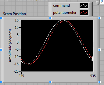

The problem that I'm having has to do with timing:  I'd like to both send commands to the servo controller and sample the analog voltages at 100 Hz (every 10ms).  It seems that my system is doing this, but there is some kind of delay between sending position signals and acquiring voltages, and I don't believe it's hardware related.  Here is the output on a waveform chart of the command vs. the actual position, showing the delay:
delay.png I'm not sure if I have all the DAQmx stuff set up correctly.  Another thing I noticed is that if I put a delay in one of the outer while loops (going through successive tests), the DAQ seems to still be reading and logging the signals even while it's not in the Timed Loop.  If I put a Stop Task after the Timed Loop, this problem goes away, but putting a Start Task before the Timed Loop doesn't seem to help at all.

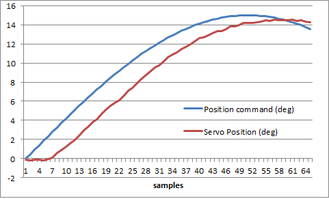

In looking at some of the saved data, I noticed that there is this delay at the beginning where the analog signal starts getting recorded for apparently about 5 loops [50ms] before the servo starts moving.  I don't know why this would be, and again can't imagine hardware as the issue, because the Parallax Servo Controller should take at most 4ms to write the command (so I could understand a 1 loop [10ms] delay, but not for 5 loops).

It could be the servo controller- note that the actual versus command tends to initially lag then lead commanded position on the rising and falling edges of the sine wave. This could occur in an mis-tuned system.
Are there servo tuning parameters you can adjust such as PID, acceleration, deceleration, feed-forward, etc?
Is there a load connected to the servo?

The other reality is that the servo itself has a controller inside it (PID I assume) which takes a reading from its internal potentiometer (which I've hacked into and am reading with the DAQ) and tries to match that to the PWM signal it's receiving.  I really have no influence on this whole control system or the tuning parameters for it.  Maybe someonen does (employees at Hi-Tec?), but again I don't think this is necessary.  I believe the servo is faithfully following commands, there just seems to be an initial delay between the first instruction and when it starts, but after that everything is good.
It also doesn't matter how slowly I move it (changing the oscillation frequency of the command signal), it still has this delay.  There is no load at all on the servo.
