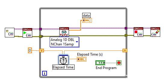

Looking at LabVIEW's example VIs was the most helpful with this problem.  In LV2018, I looked at:
Example Finder > Hardware Input and Output > DAQmx > Analog Input > Thermocouple - Continuous Input.vi
Adding a DAQmx start task and end task block outside of the loop (as shown below) reduced the loop time from 1.2 sec down to 0.28 sec.
Adding those blocks solved this particular question.  To optimize my larger code, I still need to move the DAQmx task to a separate loop from the measurements I want updated at a higher frequency... but that will require a much larger overhaul.
