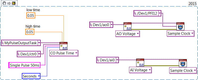

Hi Stockson,
I'm trying to implement your scenario.
Indeed there are points that I didn't properly understand.
Here is a staff that I've composed, based on your propositions (at least as I understood them).
As you can it's only rough draft ... only few connetctions are wired.
For example for me it was not clear 2nd point: sampling source management for AI ?
Counter task is configured as follows:
Output terminal: PFI12
Trigger Source: PFI0
Edge: rising
Trigger Type: Digital Edge
High time: 50msec
Low time: 50msec
Idle State: high
Should I create an additional task that outputs square waveform (with period that corresponds to the timing of my while loop on PFI0 output) and also make it sampling source for AI ?
Thanks in advance.
Pavel.

Hi Stockson,
Thanks for feedback.
I've tried "Retriggerable Single Pulse Generation" example. It works.
Then I've tried to implement the similar staff for my case.
Here is the code
Unfortunately an error is generated on running:
I didn't understand what this error means, as I've only one virtual channel. Here is snapshot from Counter task settings:
Message 20 of 28
