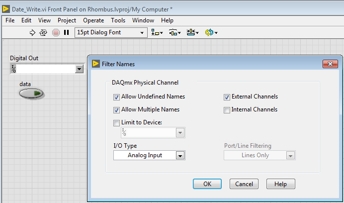

Your name filtering is wrong!  Right click the Controls and open the filter options dialog

Actually, I have a physical NI DAQmx hardware which is USB-6509
I am interfacing it with SCB-100 breakout box.
I have done several other projects with this hardware but without using a sub vi.
now i would like to use sub vi. Unfortunately I could not able to see any channels.
I have attached additional file where you can see the channels i have used and it's working fine.
