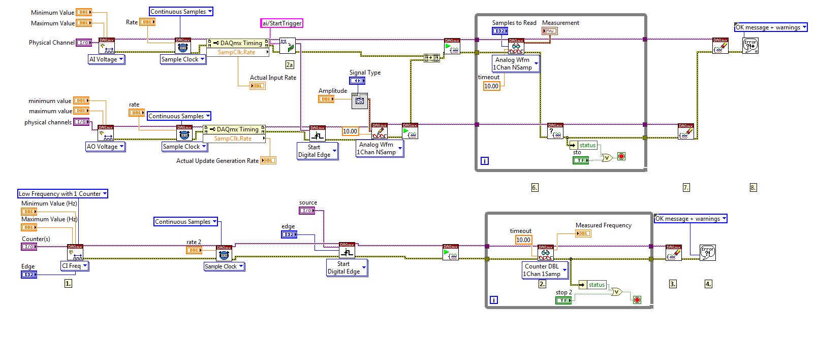

I am using NI 9263 for AO, NI9225 for AI (two channels) and NI9401 for counter frequency measurements. All these tasks should be synchronised. I've seen a lot of different examples how to perform this process, but i could not get my head how to implement a frequency measurement part.
I was using the code "Multi-Function-Synch AI-AO" and was trying to add a frequency code.The issue is that I can't even start the code, since my digital trigger for the frequency code does not work. I was trying different options, but without any success. AO and AI are synchronising without any complications by using this trigger, but the CI code. Is anybody able to help me with this question? Thank you in advance.

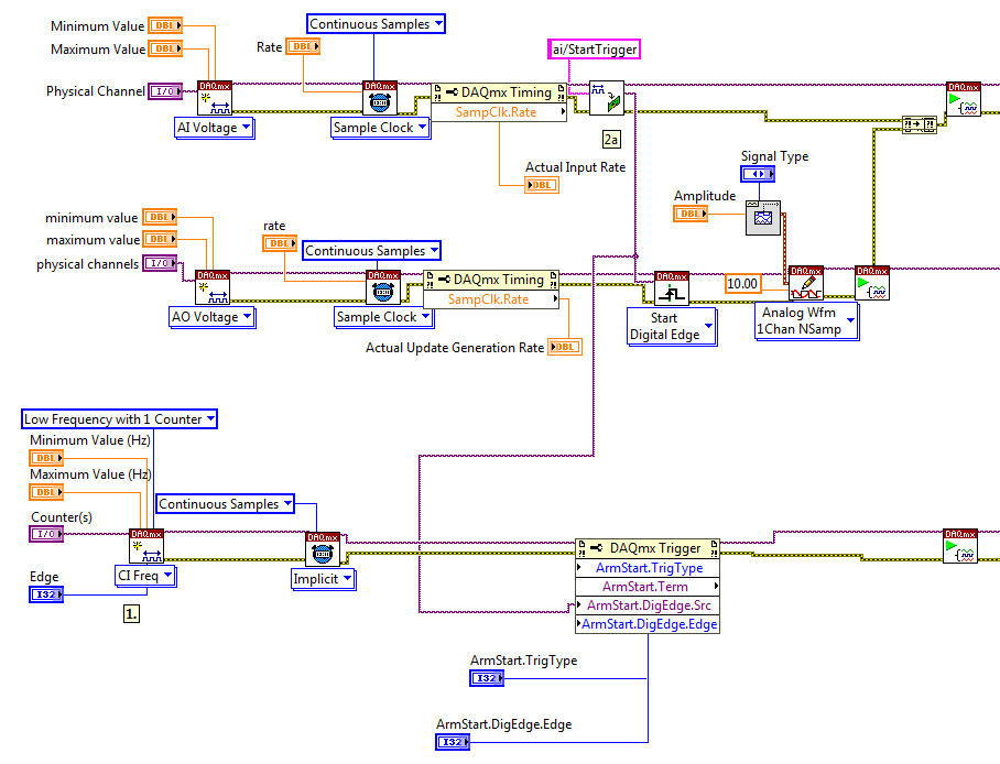

Most counters from NI require the use of an "Arm Start" trigger for counter *measurement* tasks.  The regular Start trigger can only be used for pulse *generation* tasks.

Thank you Kevin,
When I start to google about an Arm Trigger, I found some examples. Even though you are not an expert in DAQmx. but your vision is absolutely correct. I modified the code a little bit, so I am wondering, should I was a sequence structure in order to run "master" and "slave" tasks, or this trigger solution will be enough to ensure that we will start acquisition at the same time?
And mainly the reason being is that I am planning to log this data, hence I need to be sure that it is perfectly synchronised.. In any case, Thank you very much for your help. If anybody else has something to share, my ear are open.

No need for a sequence structure, just wire the *output* error cluster from the frequency task's call to DAQmx Start up to the 'merge errors' node (after growing it by one input).  This will enforce the proper sequence that your master AI task starts *after* both AO and Counter have started.
There's a possible additional subtlety you'll need to explore.  Here's what I *know*: various NI devices treat *period* measurement a little differently.  Some of them will buffer a 1st measurement upon receipt of the 1st active edge after the arm start trigger.  In this way, the first buffered sample gives an accurate time period from the trigger to the beginning of the first full interval.  The 2nd edge marks the end of the 1st full interval, and buffers it as the 2nd sample.   Other (generally newer) devices will only measure full intervals.  So the 1st buffered sample measures the 1st full interval and occurs on the 2nd active edge.  These devices provide *no way* to know the time from trigger to 1st edge.  I consider that a poorly considered design
decision.
Having said all that, I'm not sure if Frequency measurement has the same kind of differences across various devices.  My hunch is no.  Despite the fact that period and freq are just reciprocals, the meaning isn't quite so interchangeable.  Measuring a partial period (to know the time from start to 1st edge) can be meaningful.  Calculating a frequency from that partial interval is *not* meaningful.  My hunch is that on all devices frequency measurement buffers its 1st sample at the end of the 1st full interval which is defined by the 2nd active edge after trigger.
Here's the problem:  devices which do not buffer a sample on the 1st edge after trigger give you no good way to sync up the sample times of your frequency task to the sample times of your AI and AO tasks.  The only workaround I know of is to make a 2nd unbuffered counter task that measures "2 edge separation" from the trigger signal to the first freq edge.
