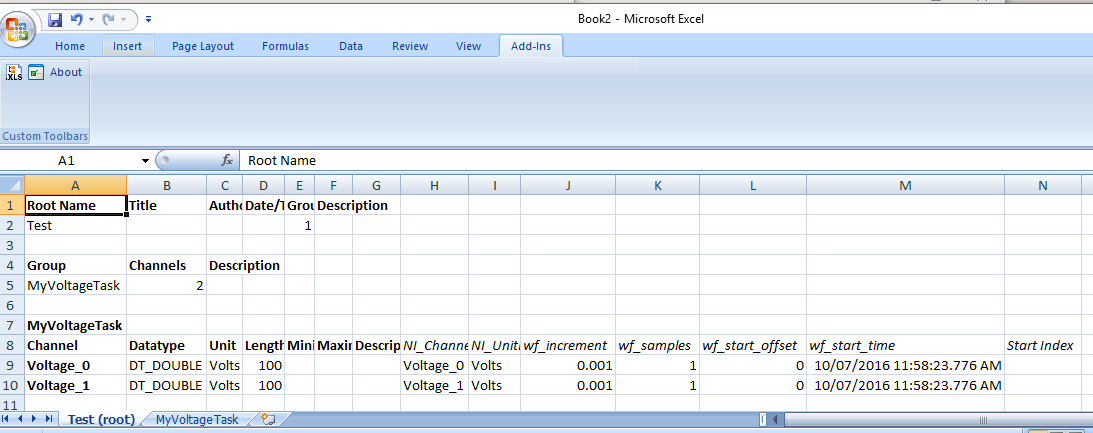

Where I had MODIFIED [CAUTION: Involves modification of NI supplied Driver-  USE a copy rather than corrupt yopur DAQmx Install]  DAQmx Read (Analog 1D Wfm NChan NSamp).vi by changing the Display Format of Data.t0 to
%<%.3X\n%x>T
and.... Ta-Da! (insert trumpet and harp fanfare here)
wf_start_time displays mSec resolution!  Cool!
NOW the bad news.  To verify I reverted the DAQmx vi and I still see mSec resolution in Excel using the TDMS importer Add-on
So, it begs the question- what version of DAQmx are you using?

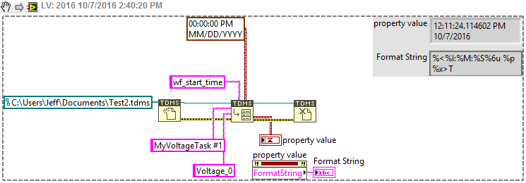

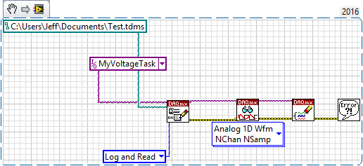

wf_start_time is read only that won't play
Here is what I have in LabVIEW 2016.0 (32 bit)
I'm not reproducing your problem as you can see
Message 10 of 14
