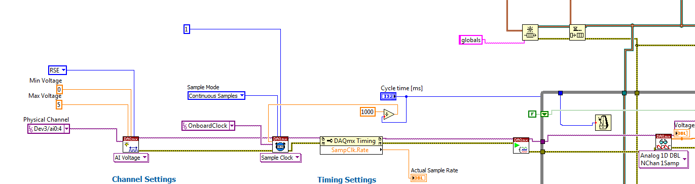

But what if you base the control on the reading of the DaqMX (the aquistion)? Than you would base the time increments on the Daq speed? It is not possible to force the aquisiton to run at the same rate?
This is what I tried:

1. Do NOT wire up the Samples Per Channel on the DAQmx Timing VI.  You are just limiting the buffer and are likely to cause errors.
2. Do NOT use a wait inside of your acquisition loop.  As Jeff said, the DAQmx Read will wait for the next sample to come in.  So that VI will limit your loop rate.  The DAQ will sample at the rate you tell it to with the DAQmx Timing VI.
3. Use a queue to send the data from your acquisition loop to your control loop.

First of all, you don't have a Timed Loop. That is s very specific type of loop. Second, it is silly to specify timing and then use 1Samp acquisition mode. You switch to software timed acquisition when you do this and that is not very accurate and is subject to jitter. If you want to acquire x number of samples at an exact rate, do what Jeff recommended in the example.

I implemented it now like this. But I don't get a fixed timestep between the log points..The upper loop runs at 1 Khz while the log interval is set to 100 ms (10 Hz).  The odd thing is also that I get the timestamps double in the log. What could cause this?

Of course you don't have consistent timestamps because you have not changed your acquisition type as previously told.

But implementation is the same as that of the example 'Voltage - Continuous Input.vi' right? What is wrong with my variant? Or should I use  100 sample aquistion mode.
