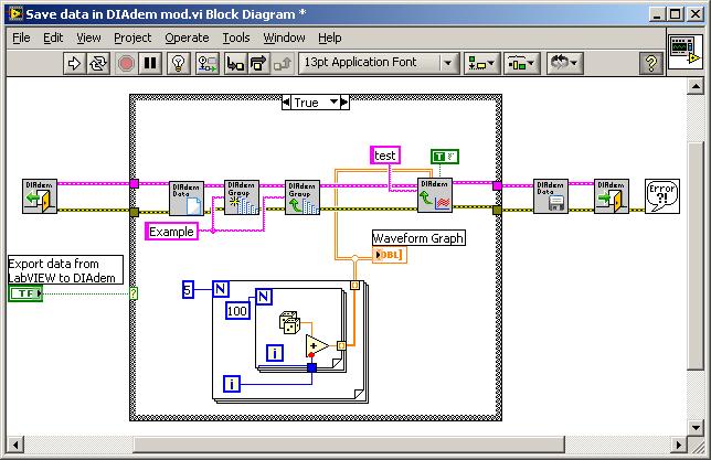

I am writting a Labview code using DIAdem export channels.vi but when I put the channel name specifying the group ("newgroup/channel1") the data is written in the set defaul group not in the group "newgroup" as I wish. any idea will be helpful? thanks

I have created an example for you. You only need to change the default group name for the specific one that you want.
Let me know if you have any problems.
