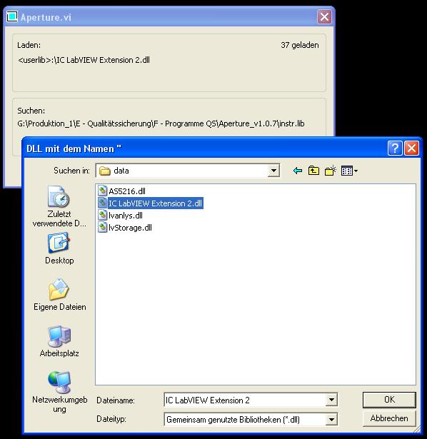

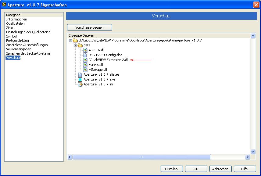

I have written a LabVIEW program that uses a DLL called "IC LabVIEW Extension 2.dll". If i build my program with the Application Builder, the DLL file is included in the DATA folder. But when I start the .exe, it cannot find the DLL. If I then manually select the DLL in the DATA folder, it works (I have to do this twice).
Does someone know how I can solve this problem? I need to deploy and I am running out of time.

I have tried this, but it does also not work. It keeps asking for the DLL.

  1. Select Tools » Options. Select Path and VI Search Path from the pulldown menus.
  2. Uncheck the Use Defaults checkbox.
  3. Use the Browse button to select the path to the directory in which you are storing the DLL
Have you dont the above steps.
