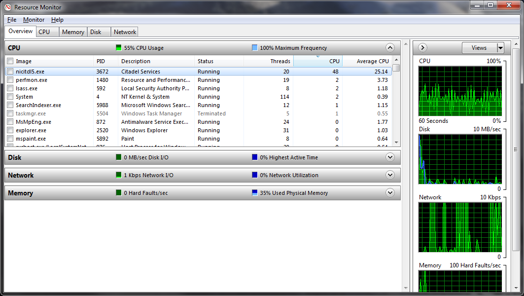

I have LabVIEW + DSC 2012 SP1 installed on my PC (CPU: Intel Pentium D 925, OS: Windows 7 Ultimate SP1 x86). When I boot up my PC, without doing anything, the CPU usage by nicitdl5.exe consistently oscillates between 45% and 10%:

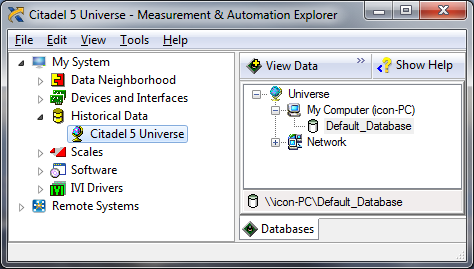

Why would this be? I have no shared variables deployed on my PC, and I have no databases in the Citadel 5 Universe:
