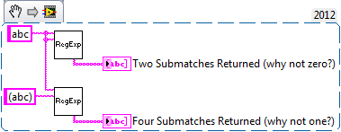

Orthogonal to your original post, but still likely of interest to those reading this topic (and incidentally, unashamedly bumping a legendary thread) -- why does Match Regular Expression_Execute.vi return more submatches than expected in the array?

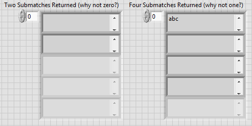

In the snippet below, the arrays return two and four submatches, when I would expect zero and one submatch respectively:

I can only infer the source of the bug since I can not see the actual code, but the pattern is very consistent:  It seems the number of submatches being produced is equal to the length of the offset array.  This is wrong on two levels, each submatch is two elements in the offset array (begin,end) and the first two elements are for the whole match.
That is why I usually stick with offsets and find the submatches myself, or know beforehand how many I expect from the regex (not flexible). Or the program-around-the-bug method of setting the new length to (len/2)-1 (yuk).

First, that VI is really meant to be an internal VI used for the implementation of the Match Regular Expression function (the one you can drop from the palette). I didn't intend for people to call it directly. If you want an official version that is on the palette then maybe you should create an Idea Exchange entry for it. I'll vote for it.
As for why it returns extra entries, that is indeed a bug that went unnoticed because of the way it is used in the Match Regular Expression function. My excuse is that I was an intern when I wrote it. 🙂
I created CAR# 385272 for this issue. I can't say when it will be fixed.

This issue is fixed in the latest LV 2013 beta. I believe it is reasonable to expect that it will be fixed in the LV 2013 release.
