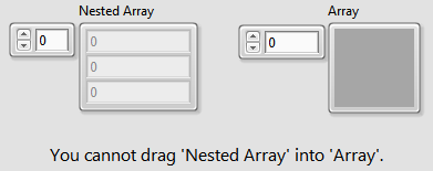

When I first learned LabVIEW over 13 years ago, one of the things that stuck with me from my LabVIEW Basics course was that LabVIEW does not support creating an array of arrays:

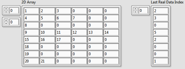

One way that developers have tried to combat this limitation over the years is to create a 2D array of the appropriate data type, then keep a separate array indicating the column index of the last "real" data value within each row of the array:
This method works, but requires storing lots of garbage data that you don't need, and it also requires maintaining the separate index array, which can be a headache if you are frequently manipulating the contents of the array.

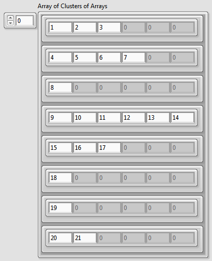

The best trick I know of for storing arrays of arrays is to stick an extra cluster in there, like this:

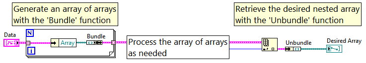

This technique effectively allows us to store arrays of different lengths within an array.  No more garbage data, and no extra work required to keep track of how many values are in each array.  I have used this technique many times over the years when I need 'array of array' functionality in LabVIEW.  When you are generating the 'array of arrays' on the diagram, you can do so with a Bundle function to add the extra cluster, and likewise use an Unbundle when you need to retrieve one of the nested arrays:
