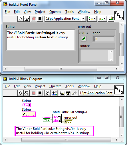

It can sometimes be difficult to deal with the formatting of strings on the front panels of user interface VIs.  One problem in particular I've often had is bolding certain text in user-visible strings.  One handy solution is to use [LabVIEW]\vi.lib\utility\error.llb\Bold Particular String.vi in the following manner:
As you can see, any string contained in <b></b> tags will become bolded in the display string.  This solution is much easier than having to find the correct character indices yourself.
