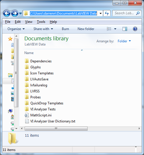

Have you ever looked in your LabVIEW Data directory?  There can be a lot of stuff that piles up in there.  Here's what's in mine at the moment:
On Windows 7 or Vista, your LabVIEW Data directory will be in C:\Users\[username]\Documents.  It's a different location on other operating systems...you can use the VI I linked to above to figure out its specific location on your system.
Now one purpose of the LabVIEW Data directory is to serve as a data storage for files generated by your own VIs, whether they be log files, configuration files, data files, etc.  But as you can see from the screenshot above, LabVIEW itself stores quite a bit of stuff in there, too.  This is not a comprehensive list, but here's a description of each of the items in the screenshot above, all of which are either automatically generated by LabVIEW, or are used directly by LabVIEW features:
  • Dependencies - Stores cached dependency information for all the VIs you have ever used in vi.lib, instr.lib, and other locations.  This improves load-time performance because, whenever you load those VIs into memory again in the future, we use the cached dependency information so that we don't need to read linkages from the VI file on disk to recalculate dependencies.
  • Glyphs - Contains the glyph library for the NI Icon Editor.  The contents of this folder are populated by the Icon Editor upon its first use after a LabVIEW installation.
  • Icon Templates -Contains information pertaining to user icon templates in the NI Icon Editor.
  • LVAutoSave - Stores temporary VI save information for the Automatic Saving for Recovery feature.
  • lvfailurelog - Stores log files that contain internal error information.  These files are created when you select the "Investigate internal error now" or "Investigate later" options in the Investigate Previous Internal Error dialog box that comes up on LabVIEW launch following a LabVIEW session in which an internal error or crash occurred.
  • LVRSS - Contains information pertaining to the RSS feeds provided by the Getting Started Window.
  • Probes - One of multiple locations for storing custom probes.  This is the default location where new custom probes are saved.  It's also where I keep my History Probes. One cool thing about keeping probes here is that they are available in all LabVIEW versions you have installed on your computer.
  • QuickDrop Templates - This is where merge VIs for Jarrod's Ctrl-G shortcut for Quick Drop are stored.
  • VI Analyzer Tests - Contains user-specified VI Analyzer tests.  This is the location you should place any VI Analyzer tests that are not installed by the VI Analyzer Toolkit or some other VI Analyzer test suite.
  • MathScript.ini - Configuration file for the MathScript Window.
  • VI Analyzer User Dictionary.txt - Contains all custom user-specified words that are not in the default VI Analyzer Spell Check dictionary.
There are many other items that can be stored in the LabVIEW Data folder...these are just the ones I happen to have right now.  If you find any other mysterious items in there, let me know, and I'll try to help you figure out where they came from.  🙂
