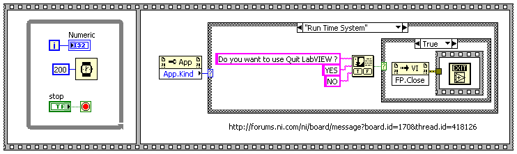

 Here is an example that shows the use of the Quit LabVIEW function. This would be the main VI of an application.
The "Do you want to use Quit LabVIEW ?" dialog is only there to allow you to "play" with the attached LV8.6.1 EXE.

JB-
How did you include an image without posting then editing your post?
Pnt-
The "Quit LabVIEW" primitive only shuts down the current application instance, so it is safe to run multiple EXEs simultaneously with this functionality.
Jorn-
Close.FP only closes the current front panel.  So, if you had opened other panels open under the same application instance, "Quit LabVIEW" could be used to close all panels when your Main VI exits.
See attached for an example project with EXEs.
