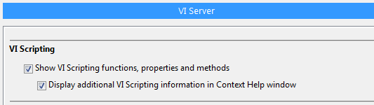

So now that VI Scripting is included in LabVIEW 2010, it is enabled via Tools > Options > VI Server:
Upon enabling scripting, you will gain access to the following items:
  • A new Functions > Programming > Application Control > VI Scripting palette
  • Scripting-specific classes (Node, Structure, etc.) in VI Server
  • Scripting properties and methods associated with scripting-specific classes in VI Server

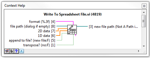

If you enable the sub-item in the screenshot above, you will start seeing helpful scripting information in the context help window for VIs and functions:
The connector pane pattern for subVIs is displayed next to the subVI title, and the terminal index of each node terminal is displayed next to the terminal name.  Note that these terminal indices are shown for built-in functions as well.
