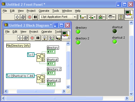

Sorry for the late nugget, I just got back into Austin yesterday from visiting family for the holidays.  Anyway, today's nugget has to do with file shortcuts and potential problems you can have with them in regards to the File I/O functions in LabVIEW.  Check out this VI, which simply uses the List Folder function to return the top-level contents of my C drive:
Check out the "folder names" list...see the "Shortcut to C.lnk" entry in there?  That's a shortcut I created to my C drive.  The fact that it appears in the folder list could pose a problem if I am using the List Folder function in a loop to recurse the contents of my C drive...specifically, I'd probably get into an infinite loop because I would keep listing the contents of C drive, getting C drive in the folders list, listing its contents, etc.  There was really no hack-free solution to this problem in LabVIEW 7.1 and earlier.  But with LabVIEW 8.0, we got a new output on the File/Directory Info function:
See the "shortcut" output?  Notice how it's TRUE when checking the info of "c:\Shortcut to C.lnk".  So now, in your recursion operation, you can check the info on a folder path before you attempt to recurse it...if it's a shortcut, don't recurse it.
Note that this problem currently exists with the Recursive File List.vi on the File I/O > Advanced File Functions palette in LabVIEW 8.2.  I am going to fix this VI in the next version of LabVIEW so that it does not recurse shortcuts.

Yup, unless some doofus names one of his folders something like 'folder.lnk'.  Then you have to add a check for that...and there's probably other corner cases you'd have to hack around too.  I think using the 'shortcut' output of the File/Directory Info function is probably the cleanest solution.
