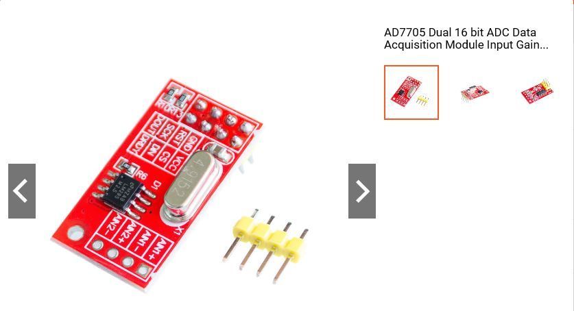

Since NI myRIO is not compatible with NI Daqmx, can we use this Dual 16 bit Data Acquisition Module in NI myrio? We want to acquire ECG signals. Thank you!Capture.JPG

You need to create a LabVIEW FPGA program to acquire data from NI MYRIO. You can get basics from here : http://www.ni.com/academic/students/learn-rio/applications/

We're kinda out of time so we're thinking of using a module instead of programming an FPGA(we are new to fpga programming) Anyone knows if this module works?

Hey dacabesas:
       You could work around programming the FPGA in a myRIO. There are several Express VIs that should be very simple to program and to use. You can check more information about this here.
Hope this helps!
