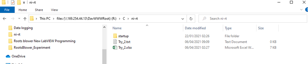

Thanks GerdW for the reply.
Yes I can browse the path, please see attached snapshot. But it not saving my file at this path too.

Hi Brijesh,
so the path should be "C/ni-rt/" (maybe you need to prepend one more slash) on your cRIO!
That "R:" is just the path to that network drive on your Windows computer…

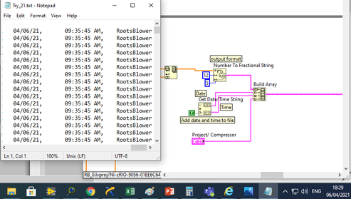

Thank you GerdW,
I have modified the path and its working. I am able to get data in .text file.
I want to save data with time. As shown in below image I am using Get Data/Time string to save each data with time. surprisingly time recorded in file is different than my laptop time. I think it is something to do with cRIO clock but I don't know how to adjust it.  Could you please help?
Kind Regards,

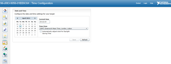

I am trying to adjust cRIO time as shown in below image, I am living in London. but this clock it self not at correct time even if I select GMT,London.
Message 8 of 9
(3,131 Views)
Thank you. Now I am able to set the clock and it looks OK.
Message 9 of 9
