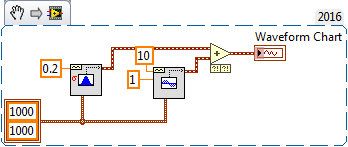

Since you are (relatively) new to LabVIEW, you need to learn about mixing Science and Engineering.  The Engineer Builds, the Scientist Experiments.  You want to Build a Chart and control it as part of a Big Fancy Instrument.  So here is a Science Experiment -- build a really tiny, simple Test system and play with it to learn how Charts work.  Here's an example:

The two Block Diagrams on the left come from the Signal Processing, Waveform Generation Palette.  The 1000/1000 cluster is the "sampling information", 1000 samples at 1000 Hz, or 1 second of data at 1 KHz.  The first block makes Gaussian noise with an amplitude of 0.2, the second makes a 10Hz sinusoid with an amplitude of 1 (quick -- what is the Signal-to-Noise ratio?).  Add them together and plot on a Chart.
See the little symbols on top of the picture?  This identifies this as a LabVIEW 2016 Snippet.  If you open LabVIEW 2016, do a Ctrl-N to get a blank VI and Ctrl-E to get to its Block Diagram, you can drag this picture from a Web Browser into your Block Diagram and it will become LabVIEW Code automagically.
I've taken the liberty of adjusting the Properties of this Chart so that (a) it displays time in H:M:S (without the date) and (b) has a width of 1 (second, the unit of Time measurement).  Run the code, see the plot, then go into the Properties for the Chart and "fiddle" with the Display Format settings for the Time Axis.  Note the difference between Absolute Time and Relative Time.  You might see that the time starts at a weird place, like 7pm -- I'll explain that in a minute.
Now go to Scales and look at the Scale settings for the Time axis.  Make small changes in Minimum, Maximum, Offset, and Multiplier until you understand what they do.
If you want to programmatically change the scale, you need to learn about Property Nodes.  But first become comfortable with the graph.
So why 7pm?  This is because you are generating Waveforms, but are not specifying the Start Time, so 0 is used.  TimeStamps are measured in UTC, with 0 representing 0 UTC on 1 Jan 1904.  If you are in a GMT-5 Time Zone, 0 UTC = -5 = 19:00 your time.
Bob Schor
